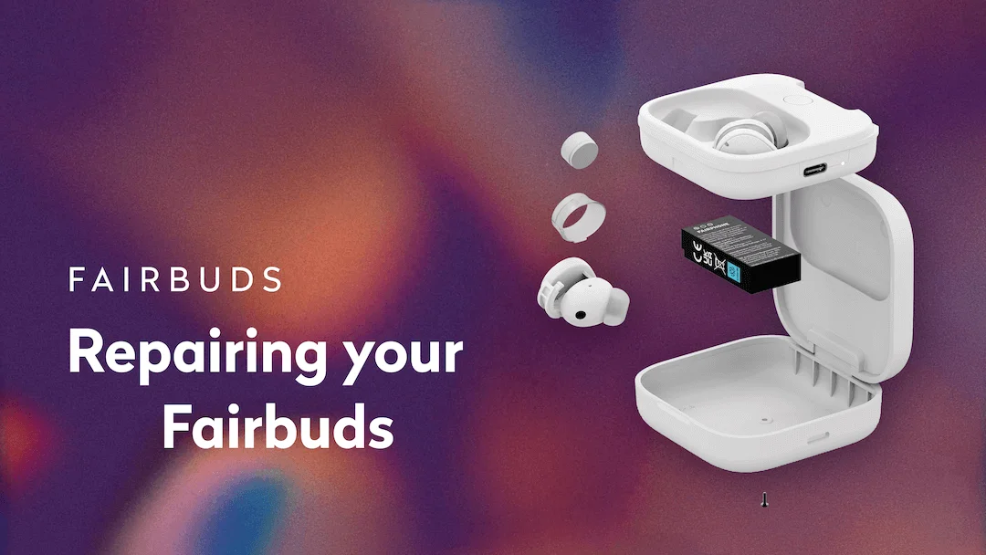

Repairing the new Fairbuds
We’re so proud of the Fairbuds, our first fully modular earbuds that are all about premium sound, designed to last. With seven replaceable parts, removable batteries in the earbuds and the charging case, and a three-year extended warranty, the Fairbuds are built to go on and on and on.
Here’s a detailed step-by-step guide on repairing the new Fairbuds. All you need is a standard Philips screwdriver. A prying tool, like a pair of tweezers or this plastic triangle, will make opening up things easier, but it isn’t essential. Keep in mind, before you start repairing your Fairbuds, make sure they’re not charging or attached to a device with a cable. Also, make sure you’re working on a flat surface.
